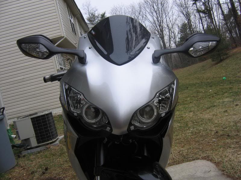

Well, after much research on wiring up dual headlights and on HID's, I decided to do a retrofit. HID's are truly designed to be used with projectors (except for the D2R's which are designed to be used in special HID reflectors). The projectors focus the HID's like they are suppose to be instead of scattering like the regular halogen reflectors do. I don't think it causes too much glare on our bikes. Well, it didn't cause enough glare to other people on the road to flash their lights at me when I just had HID's in the reflectors.
So I was happy with the HID's for awhile since they definitely were brighter than stock. But then I came across a couple of forum threads on other sites that discussed the dual headlight mod. So I kept researching and came to the conclusion that I needed to do a HID projector retrofit in order to have dual HID's that would light up the road the correct way without blinding other drivers.
Well, here is the (almost) finished project.

#5 ·
Here is what the headlight assembly looks like without the reflector in it.
Here is what the headlight assembly looks like with the projector installed in the reflector.
And this is a comparison of the projector and the regular reflector setup.
Here is the left side done and the right side opened up ready to start.
And now both finished and ready to go back on the upper cowl.

How difficult was mounting the projectors in the housing? Also i know most projectors have a cutoff inside of them and the projector on the right is crooked from what i can tell.. Other than that it looks great!! :thumbsup:
#10 ·
Yeah that pic was taken before I rotated the projector. The high beam bulb is normally rotated 90* clockwise, the notch sits at 3 o'clock instead of 12. I realized afterwards and then rotated it.
The projectors were easy to mount. They are an H7 kit. Which means that the projector housing was designed to fit into the H7 socket of the reflector.
