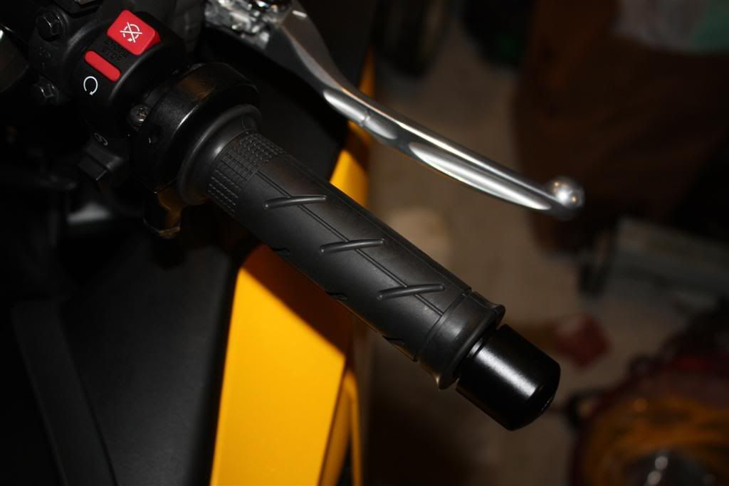

Here is my throttle tube, stock. Note I have Helibars, so yours may look a bit different, but it's the same tube. Note my cables are spun around to the bottom to allow the slightly higher bars than stock, but aside from that, same difference.

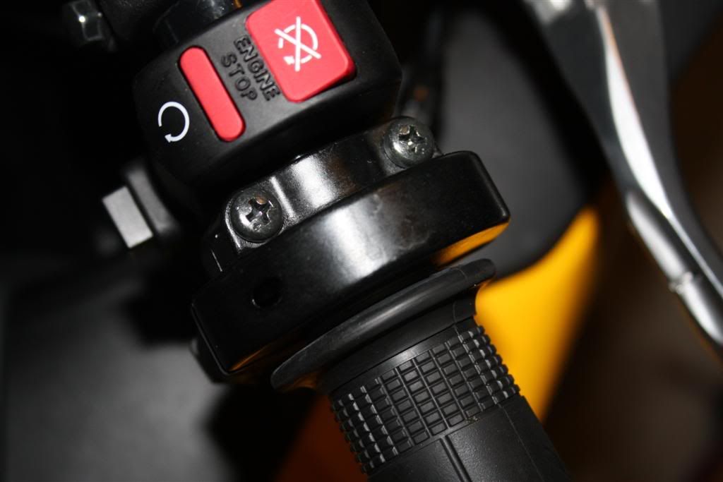

First, remove the two screws holding the throttle-tube housing onto the clip-on. On mine they are on the top, but with stock bars they will be on the bottom instead. Since mine are on top, it's actually easier to see. I've heard stories of people having big problems removing these, but mine weren't that bad. If one is too tight, try the other one first before stripping the first one off. I've also read that these are actually JIS-type screw heads, and not standard phillips, so it might work better if you use the JIS screwdriver that came with your bike, or buy a set.

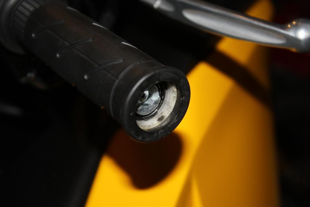

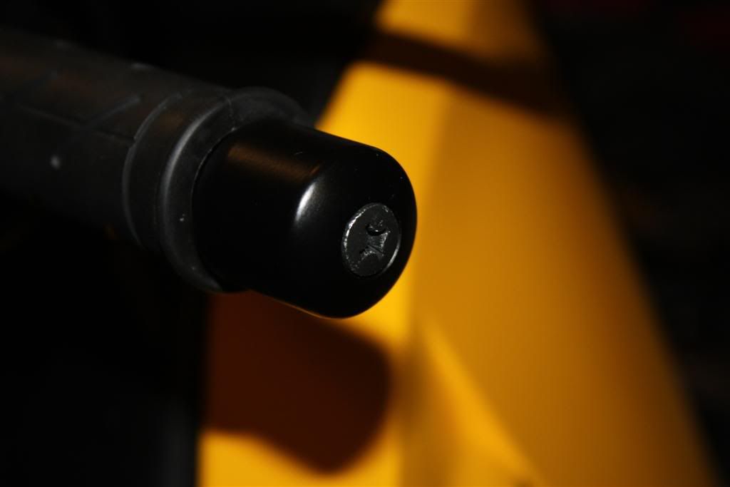

Next, remove the bar-end weight. Just hold the weight itself securely, and remove the screw in the end. It's long winded, so takes a while to back out.
Here's a shot with the bar-end weight removed. Note the throttle-tube extends out past the end of the actual bar, and the weight goes up into it.

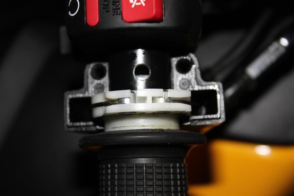

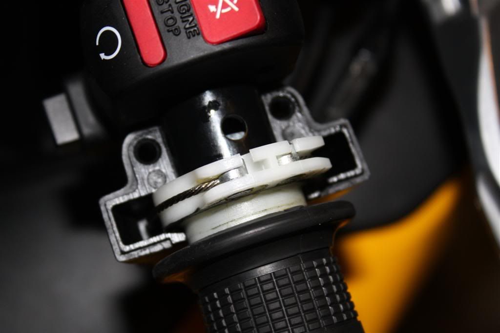

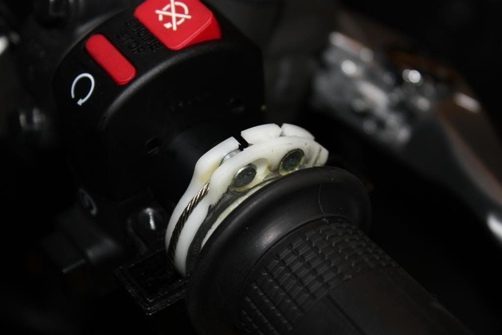

Ok, next are a couple shots of what you will see once you remove the top of the throttle-tube housing. This is the stock throttle-tube with cables still in it.
I took pics of a few angles so you could get a good view of it. Notice the housing is far larger than the cable-end of the tube, allowing room for a larger tube as well. :thumbsup:

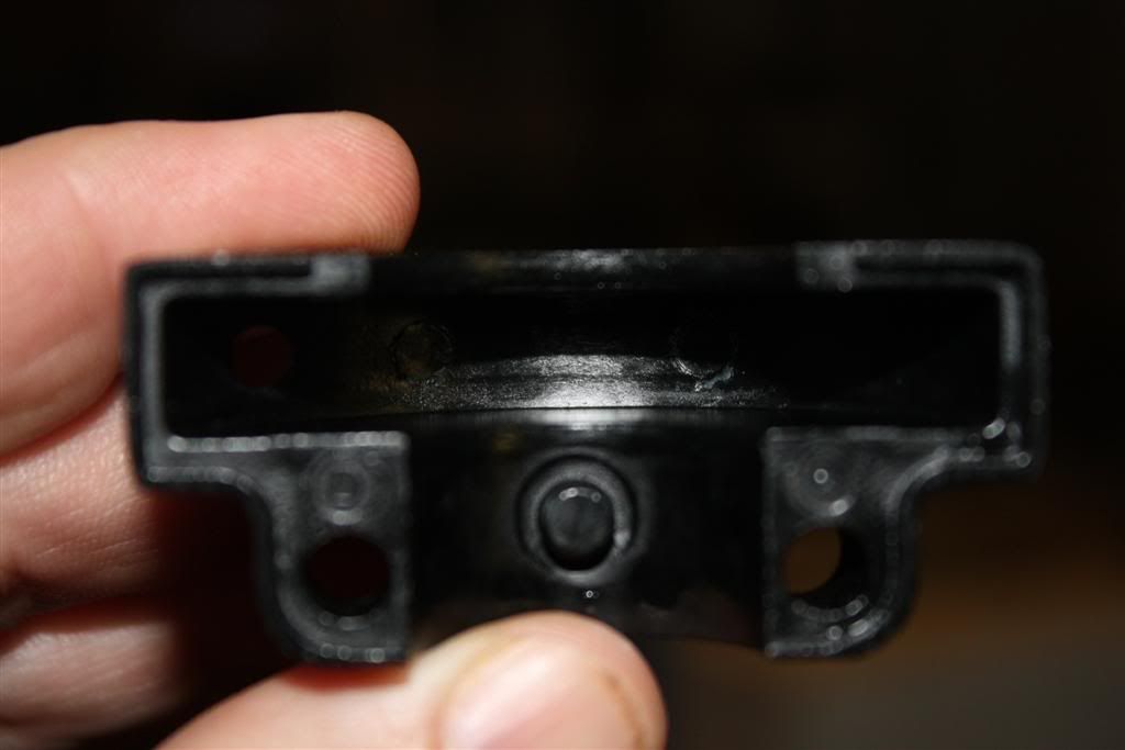

Here's a pic of the throttle cover that comes off; note it is large, and has no obstructions in it. The larger R6 tube fits fine in this side!

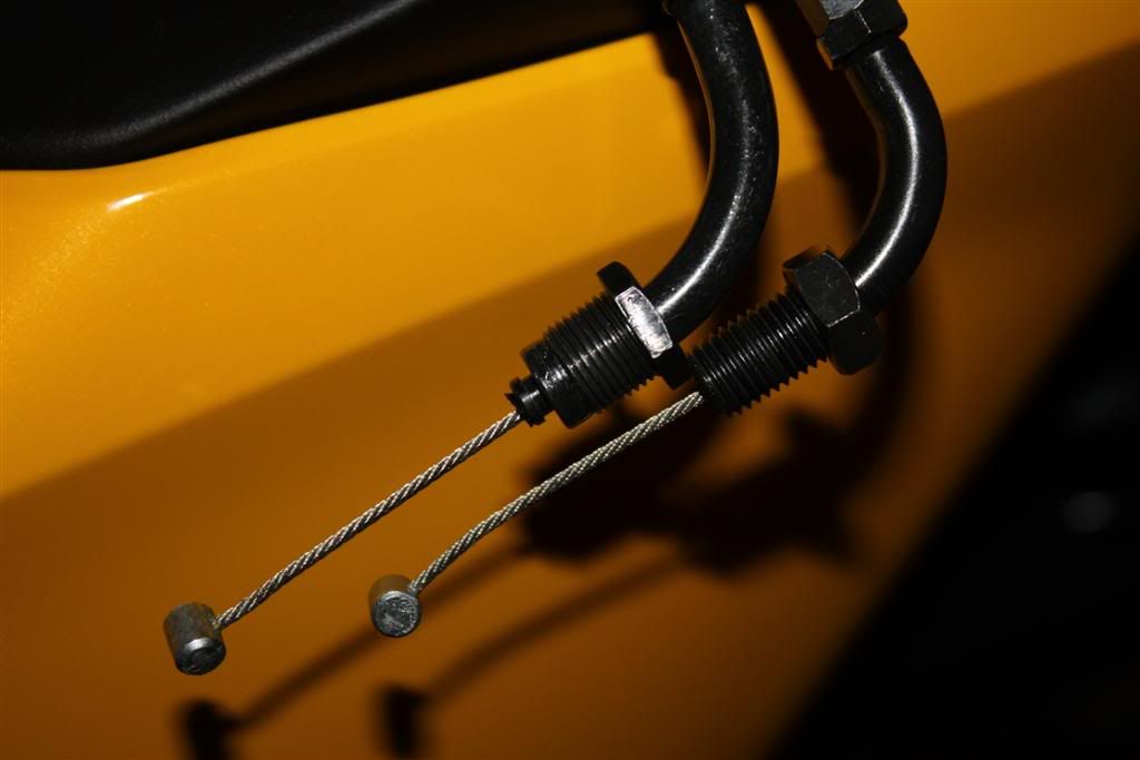

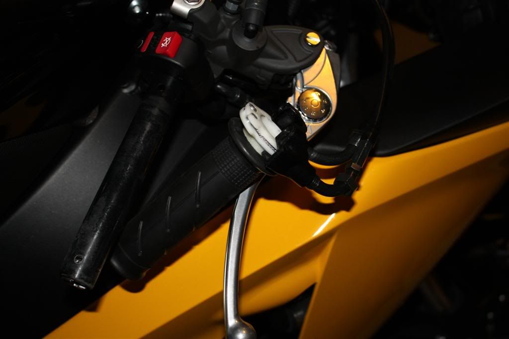

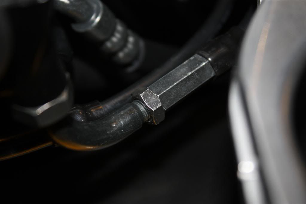

Ok, next up, we need to talk about the throttle cable connections that come into the housing. Since you will need all the slack you can get in the cables, I recommend loosening the locknuts that hold the cable elbows to the housing, and unlock the cable adjuster on the right of the pic, and screw it all the way down, as shown in the pic. You are looking to loosen the cables as much as possible here, to get them off of the stock tube, and then onto the R6 tube without having to loosen the cables at the throttle body.
I actually had to slide the throttle-tube off the bar to wrangle enough slack to get the cables out of the stock tube. I used a small screwdriver to get my fingers under the cable, and push the end of the cable out of the tube. It's not easy, so work with it, and be careful not to nick or damage the cables in any way.
Here's a shot of the end of the throttle cables, after removing from the tube entirely.

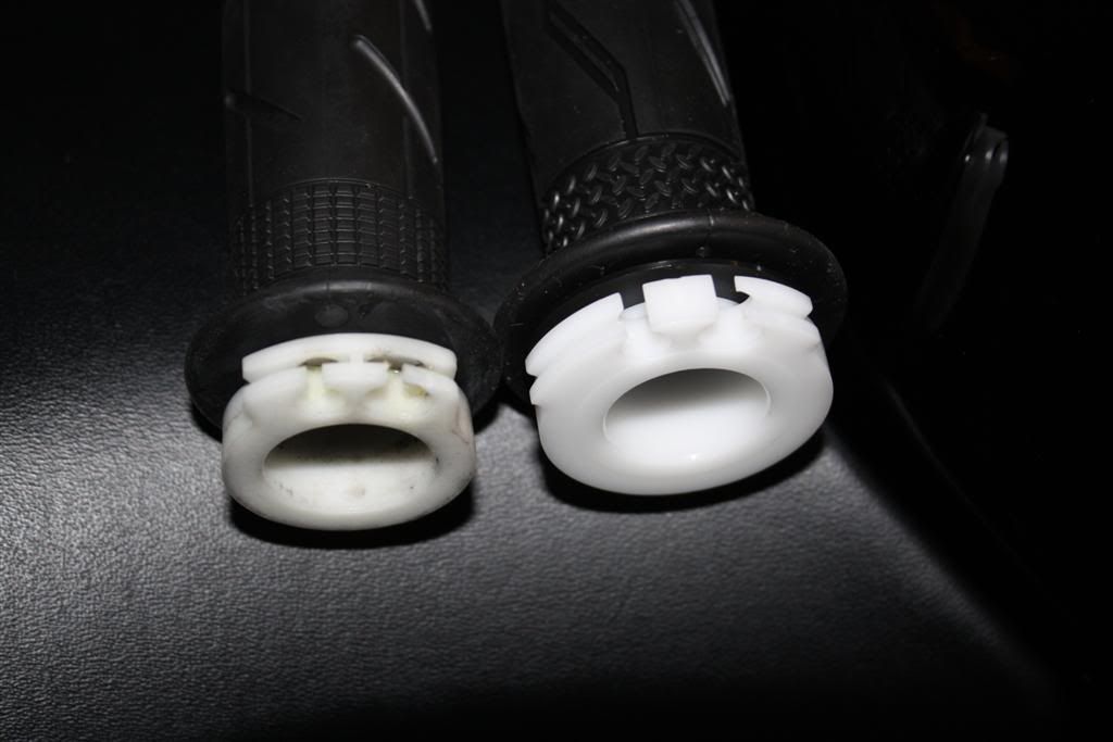

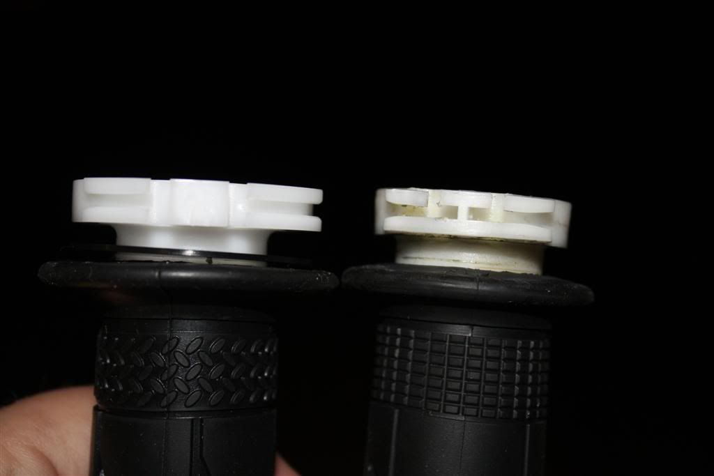

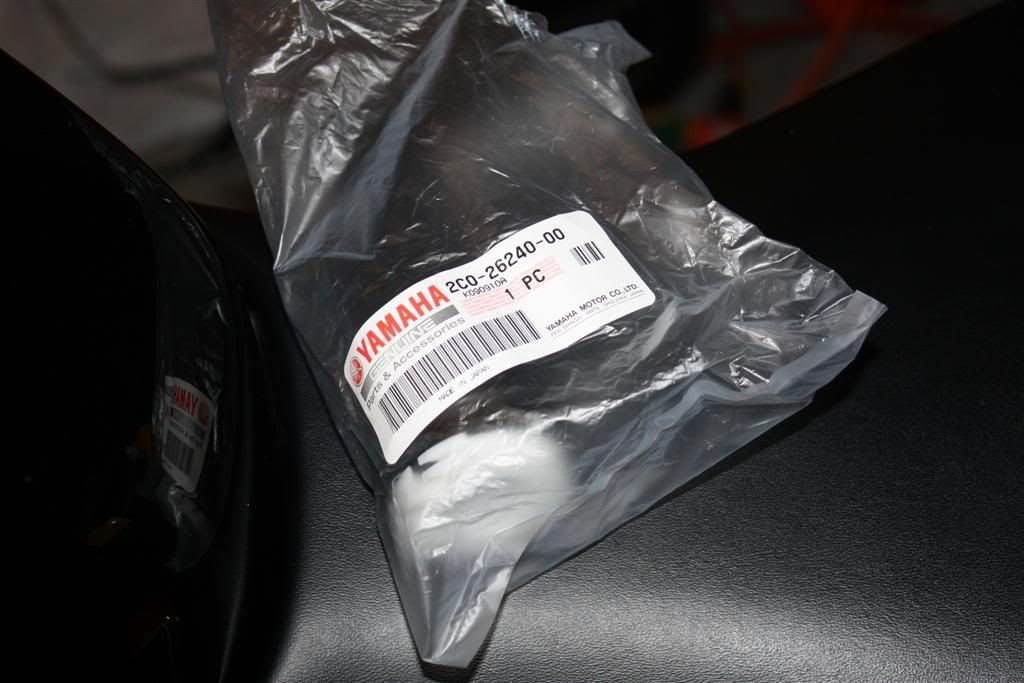

Ok, let's get to the new tube! Here's the package the R6 tube comes in, along with the part number (2C0-26240-00-00). It cost me $13 at the local Yamaha dealer, but my brother bought one a couple days later and it was $22 now, so maybe there's been a recent price increase. Either way, not much money, and the quality is good. It looks just like the Honda OEM piece, just with a larger cable end.

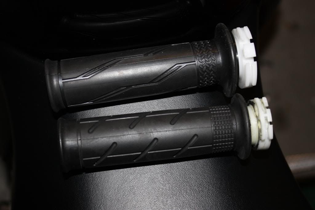

Next, here are several pics comparing the stock Honda tube and the R6 tube. You will notice they look very much alike, except for the much larger end on the R6 tube. I took a photo of the grips comparing them. The Yamaha grip is slightly different than the Honda one, but I'd be willing to bet no one notices. :) I'm leaving it until they wear out, and I'll replace both.

Ok, now we crash into the only real speedbump in the road. The other side of the housing, where the throttle cables thread into, has some metal in the way of the larger R6 tube. Some people sand down the tube itself to clear these bumps, but I decided to grind down the bumps themselves with a dremel. That way my housing was compatible with whatever tube I want to throw at it. Either way works though, you need to grind down these bumps, or the back-side of the R6 tube, opposite where the cables connect, to clear these bumps. When you insert the new tube into the housing, it becomes clear what has to happen.
In these photos, you can clearly see the bumps in the way. (I have some photos later of them after I ground them.)
Next are a couple photos showing the clearance of the R6 tube in the stock housing. Notice except for the metal bumps mentioned above, there is PLENTY of room.
Ok, time to whip out the dremel with a carbide cutting wheel. The material is aluminum, so grinds easy. 15 minutes later, I had plenty clearance for the new tube, and it fits perfectly! Here you can see the bumps, ground down enough so the R6 tube doesn't touch them at all. I'd say you have to grind like 1/32" off the bumps to make room, but I ground probably well over 1/16" to make sure there was no chance of it hitting.
Once this is done, it fits perfectly in both sides of the housing. Note, this is the main place an error could occur during the install. Be sure you grind these bumps down enough so the tube has plenty of clearance. You do NOT have to completely grind the bumps off, just enough for the new tube, and a little more to spare.

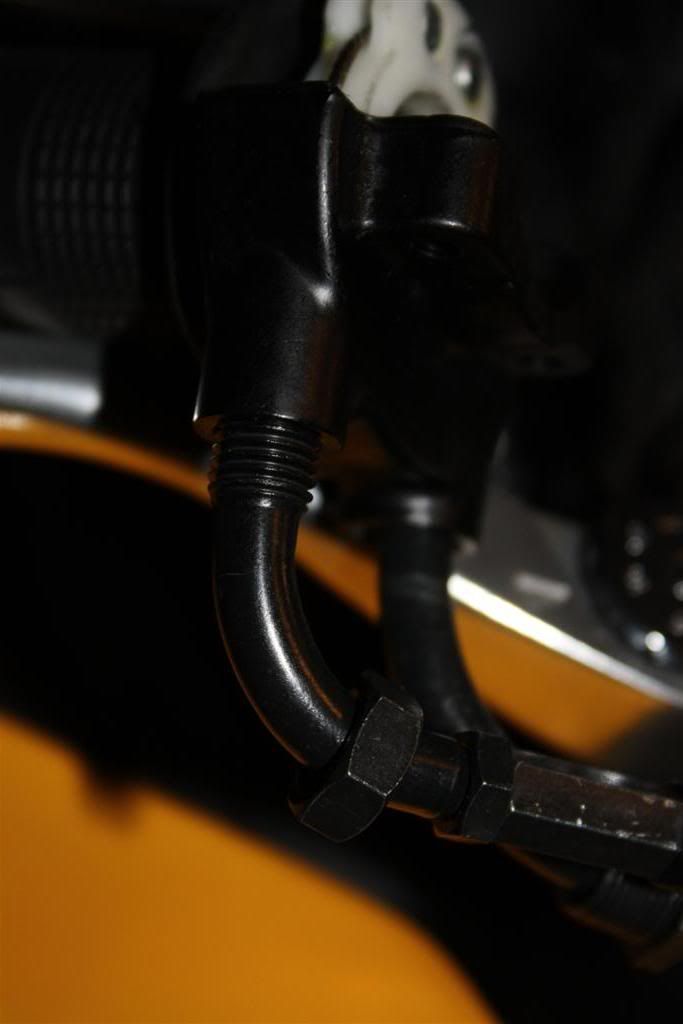

Ok, time to start reassembling. Here you will note I screwed the "accelerate" pull-side of the cable elbow much farther into the housing, to give me as much cable slack as possible. The Helibars take up even more slack, so you might not have to do this, but I had to screw this in farther, as well as set the slack adjustment nuts as slack as possible, and even then I BARELY got the cable on the new tube. Be careful with the cables and be sure not to damage them with a screwdriver tip or anything similar.
(Notice the elbow on the left is screwed in farther than it was initially above.)
Ok, here is the R6 tube, with the cables in it. It was NOT very easy in my case to get the cables in. I had to fiddle with it a while, but again take your time, work with the slack as best you can, and again don't damage the cables. Try not to twist them either, they should be as relaxed as possible, not twisted up, etc. I noticed the stock tube had a little grease on it, so I put a light coating of anti-sieze grease on most of the stuff that moves.
Here are several pics of the R6 tube installed, from various angles.

Once done tightening the housing back onto the handlebar, tighten the lock-nuts on both cable elbows so they point at the correct, most relaxed angle. Then set your proper throttle play with the adjustment nut. The service manual calls for 2-5mm (1/16-3/16) play in the throttle tube rotation.
