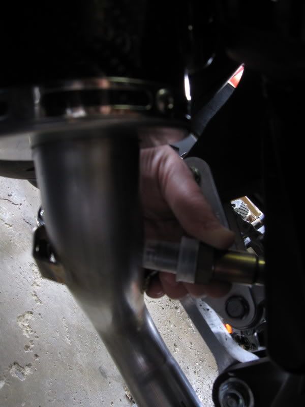

Sorry to make a little thread like this but I have an hour and a half to get this welded and I wanted to know where you guys are putting the bung for the 02? In the mid pipe with a slipon? I have the Jardine RT-5. Thanks a lot guys!!

In the mid pipe of the slip-on close to the header side.
Well I couldn't have asked for a better source on that! :thumbsup: Now running the wiring for it is the next problem. The location for the 02 allows me to run the wires behind the swingarm into the subframe.. I hope that will be okay
So would this be a bad location? I'm trying to figure out where to put it and still have a good location for the connector
That location would work also just make sure to think about swingarm movement. The closer to the header you can get though the better. Reversion could be an issue the further back you put it.
I ended up putting it right in the first bend of the mid pipe. I figured it would be better closer to the header.
