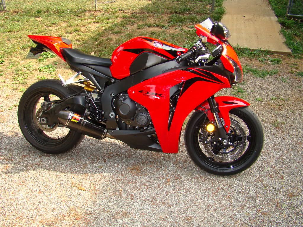

If you don't mind a traditional side exit exhaust look into the Nojima system. Send a pm to LDH from Dan Kyle Racing for more info.

Who's go a picture of an 08 in race trim with one of those Nojima systems? That looks pretty cool.
i don't think they are in the states yet, been a while
i also might have a leo stainless F/S
