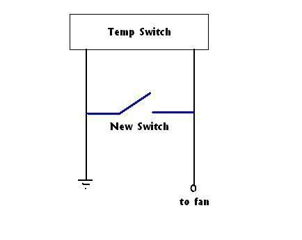

Ive not done this mod on my 08 blade yet but i have on other bikes.
Normally we run a switch straight off the radiator heat sensor. The heat sensor works by connecting a circuit when it heats and expands, som we put a switch on it.
My 08 blade radiator fan doesnt kick in till 110+, so im going to fit a switch for waiting in traffic. Still need to find it though :)
Did this on a 636 once and if its the same this is what I did...I know on my f4i it is not like this had to do it different but maybe the 1krr is the same
Like this the fan will kick on by itself at temp and also allow you to turn it on with switch
Yep thats what i did on my GSXR stunt bike.
No doubt the CBR fan runs off the ECU or something overly complex, "HONDA!".
