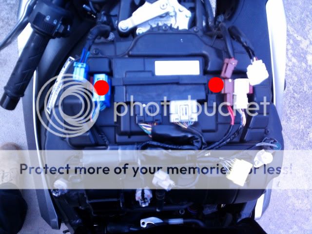

Step #3. Disconnect all 8 plugs highlighted.
Step #4. Unclip the plug furthest to the left by pulling out on the red tab and sliding it off of the bracket.
Step #5. Unscrew the 2 highlighted screws which hold the bracket over your ECM. Then rotate the wire bundle to the left side of the bike.

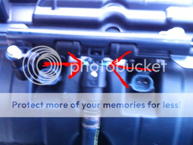

Step #7. Disconnect the fuel line from the injectors. Pull the rubber stopper out first. Then, using the needle-nose pliers to squeeze the two green tabs together pull the line down. Close your eyes when doing this, she’s a squirter. I fit a rag underneath the connector to soak up the fuel that is still in the lines. It’s not much fuel.
